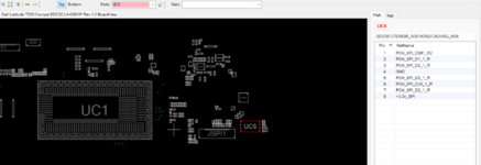

GD25B127DSIGR_SO8 W25Q128JVSIQ_SO8
16mb
Main Bios Chip Detais and location.

dfhythhh
16mb
Ok so the bios chip is 16mb
